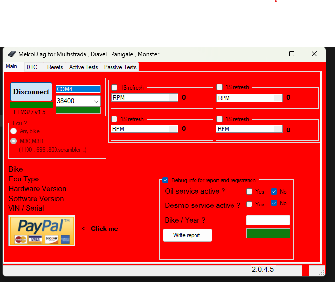

i can't get bike information for request the license.
I use ELM 327 V1.5 and everything OK after click connect but bike information is blank.
maybe i get wrong ELM connector?
i use ducati obd connector from OBDAUTO.
i can write debug info and the result like this:
"File generated On 20 Jul 2025 21:09:45"
"Software version 2.0.4.5"
"User Bike = Ducati Monster 696 2009"
" vin:7F0211
3 PIDS active founds
?_
"D21ECA4D"
"Bike = 4"

Re: Can't provide bike info | Melcodiag, Monster 696 2009
you switch on ignition ? cause i see no data coming from your bike
you use ddA conector with 4 pins right ?
don't forget to tick m3c (696) before to tick connect

Hello JPL,
I already switch the ignition on and NOT start the engine.
and tick the m3c option before connect.

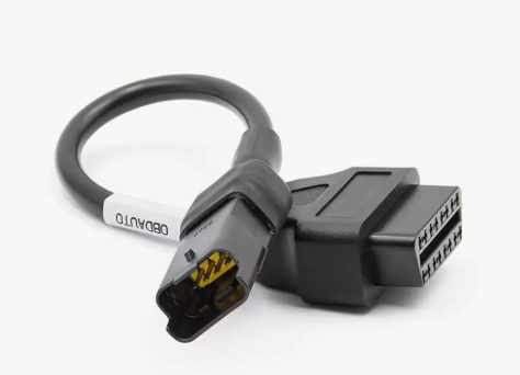

Yes, i use ddA connector with 4 pins from OBDAUTO like photo below.
I feel the melcodiag cant connect with my bike, maybe that wrong with my cable connector?
yes or a faulty elm
