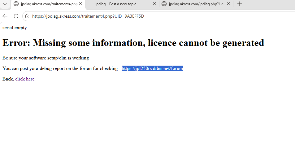

Unable to register
"File generated On 5/7/2026 7:28:21 PM"
"ELM version : ELM327 v2.1"
"Auto Detect Bike = Panigale V4S"
"User Bike = Ducati Panigale V4 2023"
"Softw = 2.0.4.9"
" vin ZDMDAGWW8PB006697"
2 PIDS active founds
"Vin = ZDMDAGWW8PB006697"
"9A3EFF5D"
"Bike = 8"
ZDMDAGWW8PB006697
The URL it gave me = https://jpdiag.akress.com/jpdiag.php?Li ... D=9A3EFF5D
Error Missing Information
- Capture.PNG (25.63 KiB) Viewed 21031 times
Re: Error Missing Information
yes it didn't collect many data .
have you tried with an other elm ?
