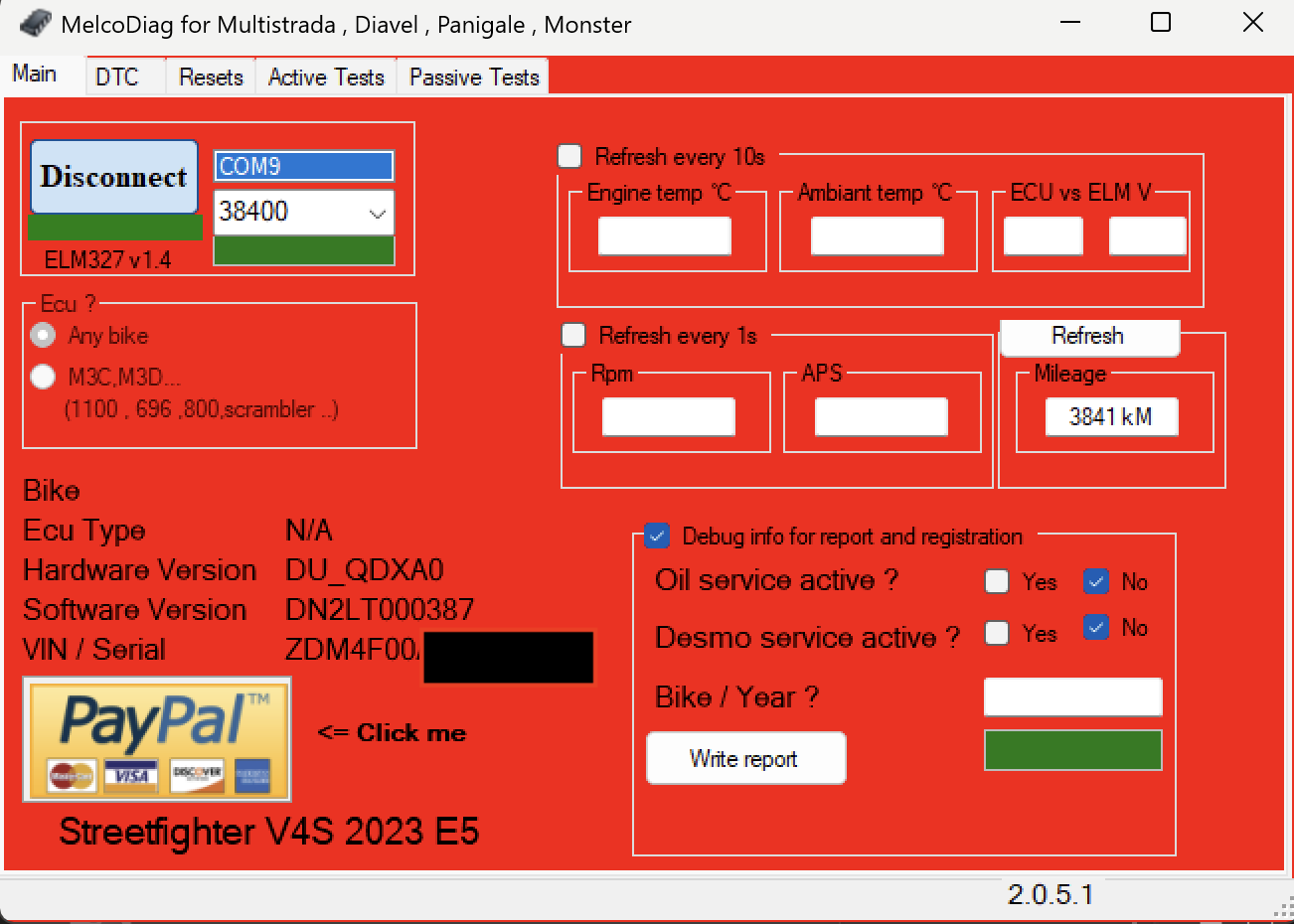

I’m using MelcoDiag with a known-good original ELM327 v1.4 USB interface (bough off of Amazon amazon.it/dp/B0F7S1W31Z). Communication with the bike works correctly, but MelcoDiag does not recognize the bike.
Bike: Ducati Streetfighter V4 S 2023 Euro 5
Detected bike code: 4F00
MelcoDiag message: “Bike not recognized: 4F00”
Estimated: Scrambler (bike=3)
Interface: ELM327 v1.4 USB
MelcoDiag version: 2.0.5.0
VIN: ZDM4F00*********
Communication seems stable
I have not attempted service reset or throttle/RBW procedures because even the mileage is not red correctly and I don't want to brick my ECU :lol:
Could anyone please confirm whether this ECU/model is supported, or whether the 4F00 bike code can be mapped correctly?
I'm pasting here diagnostic info/log (the complete VIN is masked):

Re: Ducati Streetfighter V4 S 2023 Euro 5 - Bike not recognized 4F00
thanks
it's patched you can redownload.
don't expect to see reliable data in the first menu , it's not coded yet ,
and it's safe do not worry

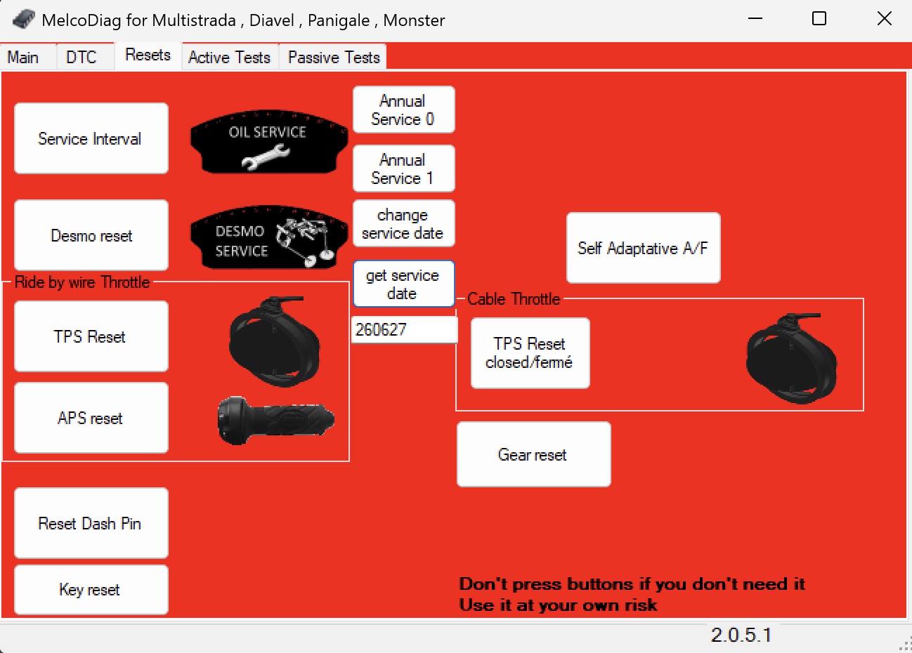

I just connected the bike but I was not able to reset the service light. I tried "Service reset", then "Annual service 0", then "Annual service 1" but none of these turned the service light off although the service date value is correctly set to today.
Thank you again for your support.
Do you think it'll be safe to also do TPS and APS resets?
