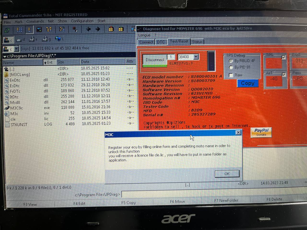

I have got a licence recently for MONSTER 696 2009 bike, with the ECU S180040101 A and serial number 285327289. I copied the "cle.lic" file into the JPDIag's folder and nothing happens (I use Windows 10 x64 as my environment, no virtualization). I still able to run JPDiag, connection with my bike is okay and I can see its IDs but there is no licence have been seen by the software. Could anyone help me please?
thanks!

Re: License
have yo done the tests in this post viewtopic.php?t=5 ?
Re: License
yes, I did.
I've tried to do the same stuff on Windows 7 platform and still having the same issue. Please look at attached picture
Thanks!
P.S. I have the siemens-continental ECU
Thanks!
- photo_5258098224932187712_y.jpg (198.41 KiB) Viewed 6581 times
Re: License
you can give melcodiag a try selecting m3c ecu.
then you can register from there if the lic is still not recognized
the old m3c9 software is not supported anymore
Re: License
Got it! The license didn't work for me with Melcodiag. I've made a new request for it! Many thanks for your help
P.S. Melcodiag has been working with the new license very well! Many thanks to author.
