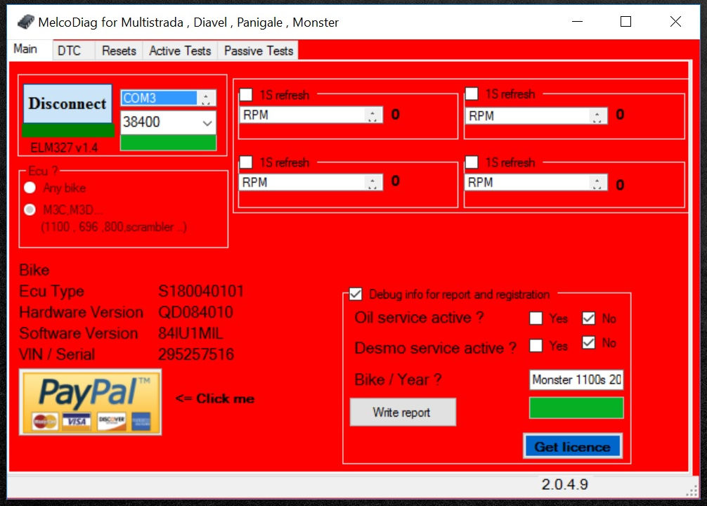

I’ve managed to get a connection to the ECU, and the software reads the ecu data and i was able to get the license.

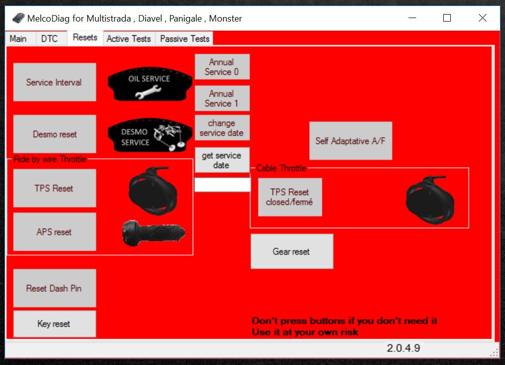

However, I cannot reset the desmo service warning. or perform a TPS reset. All buttons on Melcodiag do nothing at the moment.
From what I’ve seen, other users with similar setups are able to perform these functions, so I’m trying to understand what I might be missing.
Any guidance would be appreciated.

Running Melcodiag from a dedicated folder on C
License file is placed in the same folder. Debug shows “lic found”.
Windows Defender disabled.
Running as administrator.
Despite all this, i get "not registered" on the debug file and the TPS reset and service reset buttons remain greyed out.
Thanks again for your help!

The serial is well read when you enable m3c option ?

Thanks for your reply. Unfortunately, there is still no progress.
The ECU is read correctly and the license file is present. The debug file shows:
"File generated On 3/23/2026 7:56:12 PM"
"User Bike = Monster 1100s 2009"
"Ecu = S180040101"
"Hardw = QD084010"
"Softw = 84IU1MIL"
" vin:100E5A8C3239353221353735313620202220AAAAAAAAAAAA
8 PIDS active founds
080_0000000000000000
081_01000000C8000000
010_C800000000000000
100_0000000000200000
211_438A003DD4000045
020_0000064FA1000000
028_0000000000000000
280_2
"Vin = 295257516 "
"38AD6C6B"
"Bike = 4"
295257516hard :QD084010
soft :84IU1MIL
I have followed all the steps carefully, but the reset buttons remain greyed out.
Any further guidance would be appreciated.
Thanks.
